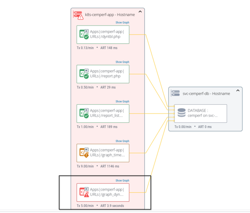

Below is a real-world example that shows application response times. The database is deployed on node2.
adm@k8s-jm-master:~/k8s/apmia$ k get pods -n cemperf -o wide
NAME                               READY   STATUS      RESTARTS       AGE    IP                NODE
cemperf-app-7d669c76c-7qqsg        1/1     Running     2 (147d ago)   300d   192.168.255.136   k8s-jm-master
cemperf-db-9774fb7d9-cvp8d         1/1     Running     0              25m    192.168.21.197    k8s-jm-node2
Here, executing an application requires large numbers of DB requests and dramatically impacts average response times on affected components, in this case an average response time of 3.9 seconds.
ESD_FY25_Academy-Blog.Cloud Application Performance - Common Reasons for Slow-Downs.Figure 1
investment300
Note: For this test, the graph_dyn function queries the database for 80k data rows where each row provides metadata to build various graph points.

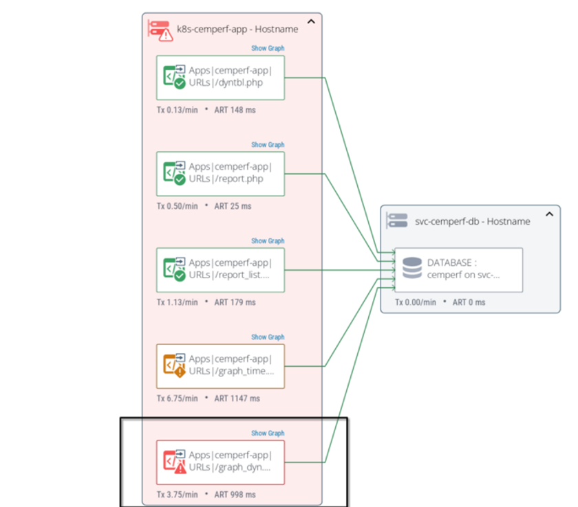

By moving the database to the same machine hosting the application part, average response time improved to 0.998 seconds!
jmertin@k8s-jm-master:~/k8s/apmia$ k get pods -n cemperf -o wide
cemperf-db-cbd45f9f6-frdwf         1/1     Running     0              7s     192.168.255.168   k8s-jm-master
ESD_FY25_Academy-Blog.Cloud Application Performance - Common Reasons for Slow-Downs.Figure 2
This enormous performance improvement was achieved by reducing network induced round trip latencies, that is, by moving the database container to the same node.
