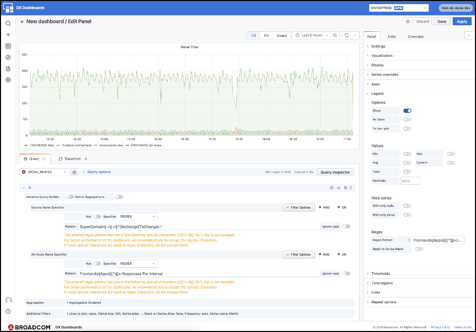

Let’s create a dashboard for our TixChange application in DX O2. We open the “Dashboards” view, select “New Dashboard”, and then “Add an empty panel”.
ESD_FY25_Academy-Blog.Regular Expressions That I Use Regularly.Figure 1
We want to display application metrics. To do so, change the default “-- Grafana --” data source to “AIOps_Metrics”. In the query builder, we notice two specifiers: the “Source Name Specifier” and the “Attribute Name Specifier”. Together, they define which data is displayed in our widget. For DX APM metrics, the Source Name Specifier specifies the agent expression; the Attribute Name Specifier specifies the metric expression. For the Source Name Specifier there are four options:
The “Source Name” consists of four parts separated by the pipe character (“|”):
Domain name|agent host name|agent process name|agent name
Domains are a legacy mechanism to filter data.  In DX APM, it defaults to “SuperDomain.” For other data it may be “UIM” or “Custom.” We want to match all agents that have an agent name containing “TixChange” or “tixchange.” We don’t care about the host and process names. I may cover the topic of  APM agent naming in a subsequent blog.
To match “SuperDomain” we can literally write “SuperDomain”. If we want to match any domain, we can write “.*” or better “.+”. The dot ‘.’ matches any character and the prefix “*” means “0-n times” and “+” means “1-n times”. So if we want to make sure that there is at least one character, we should use “.+” but most often simply “.*” is used.
Next, we want to match the pipe character. Because it is a special character in regular expressions (see below), we have to escape the pipe with a backslash: “\|”. Then, since we want to match any host name, we use “.+”. Because same holds true for the process name, we have  “SuperDomain\|.+\|.+” so far. We add another (escaped) pipe. Finally, we want to match an agent name containing “TixChange” or “tixchange”. This means “TixChange” or “tixchange” can be preceded and followed by any number of other characters (“.*”).
How do we specify “TixChange” or “tixchange”? In regular expressions, the pipe character means “or”. So “TixChange” or “tixchange” is written as “(TixChange|tixchange)”. If we do not use the brackets, the “OR” applies to everything in front of the pipe “OR” everything after the pipe. With the brackets, we define the scope of the pipe. We could also add a third expression “(TixChange|tixchange|TIXChange)” and a fourth and so on. The result is our Source Name Specifier:
SuperDomain\|.+\|.+\|.*(tixchange|TixChange).*
We need the pipes to “anchor” the pattern and ensure that TixChange is contained in the agent name, after the third pipe. If we wrote “.+\|.*(tixchange|TixChange).*”, it would not be guaranteed that “tixchange” only occurs after the third pipe. Actually, it is not guaranteed that there is no fourth or fifth pipe before or after tixchange because we match any character with “.*”. But that would not be a valid Source Name Specifier!

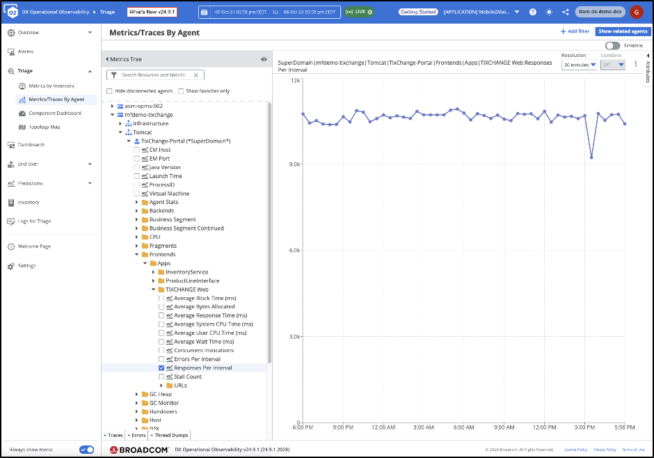

The Attribute Name Specifier has the same options as the Source Name Specifier and additional options that I will not cover here. I want to display the “Responses Per Interval” metrics for all (web) applications deployed in the tixchange application servers. The DX APM metric path usually describes the metrics and is also divided by an arbitrary number of pipe characters. You can think of every string between the pipes as a folder: you get the hierarchical, directory-like structure that is shown in the metric browser. The metric path is separated from the metric name with a colon “:”.
Note: There must be exactly one colon in a metric path. For example:
  1. Frontends|Apps|TIXCHANGE Web:Responses Per Interval
  2. Frontends|Apps|TIXCHANGE Web|URLs|shop/newOrder.shtml:Responses Per Interval
  3. GC Monitor|Memory Pools|PS Eden Space:Amount of Space Used (bytes)
If we want to match the first metric and all other applications, not just “TIXCHANGE Web”, we need to generalize that string for our pattern.
Note: Remember to escape the pipe characters, i.e. “\|”. If there are brackets like “(bytes)” or “(ms)” you have to escape the brackets, too: “\(ms)\”.
“Frontends\|Apps\|.+:Responses Per Interval” would not only match the first metric but also the second metric because “.+” also matches “TIXCHANGE Web|URLs|shop/newOrder.shtml”. If we want to match only metrics on the “Apps” level and not the individual URL metrics, we must make sure that there are no pipe characters in the matched string.
Classes can also be used to exclude a group of characters: “[^a]” means “any character but “a”. So, we will use “[^\|]+” (pipe must still be escaped) instead of “.+”:
Frontends\|Apps\|[^\|]+:Responses Per Interval
Now we have defined regular expressions for both the Source Name Specifier and the Attribute Name Specifier.
In the query panel under “Additional Filters”, you can define the series name. “Source | Metric” will show the full Source and the Attribute Name Specifiers. You can omit the Source or use “Metric Path” to cut off at the “:” character. You can also show only one of the four Source segments (domain, host, process, agent name).
If that is not short enough for you, you can open “Legend” under “Panel” on the right. There you find a REGEX to “extract” a part of the metric path as legend. Only what you put in brackets will be used as name: “Frontends\|Apps\|([^\|]+):Responses Per Interval” will extract only the application name.
ESD_FY25_Academy-Blog.Regular Expressions That I Use Regularly.Figure 2
Helpful hint: The query is only executed when you leave the text box where you typed or pasted your REGEX. To test your query, click anywhere outside the text box.
